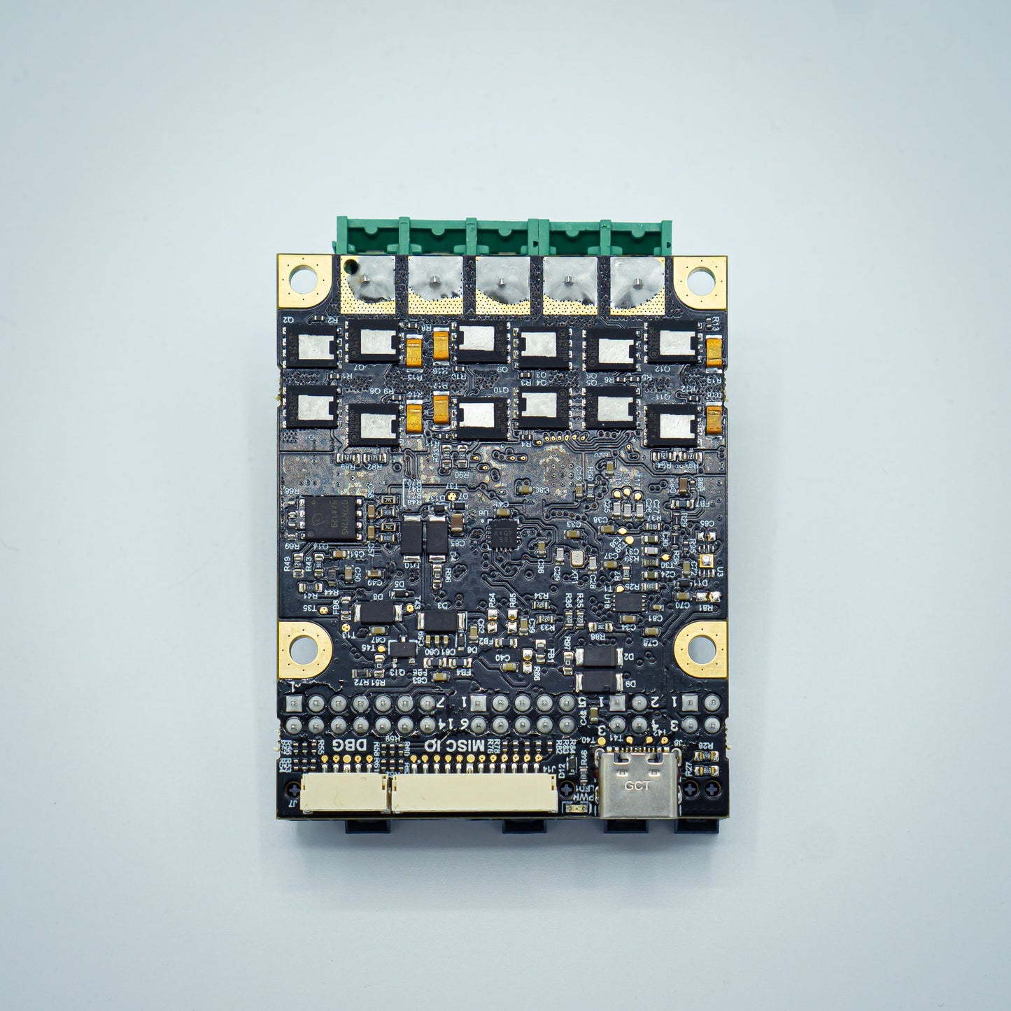

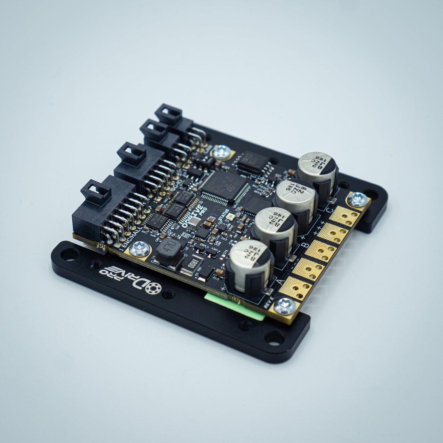

Power pads

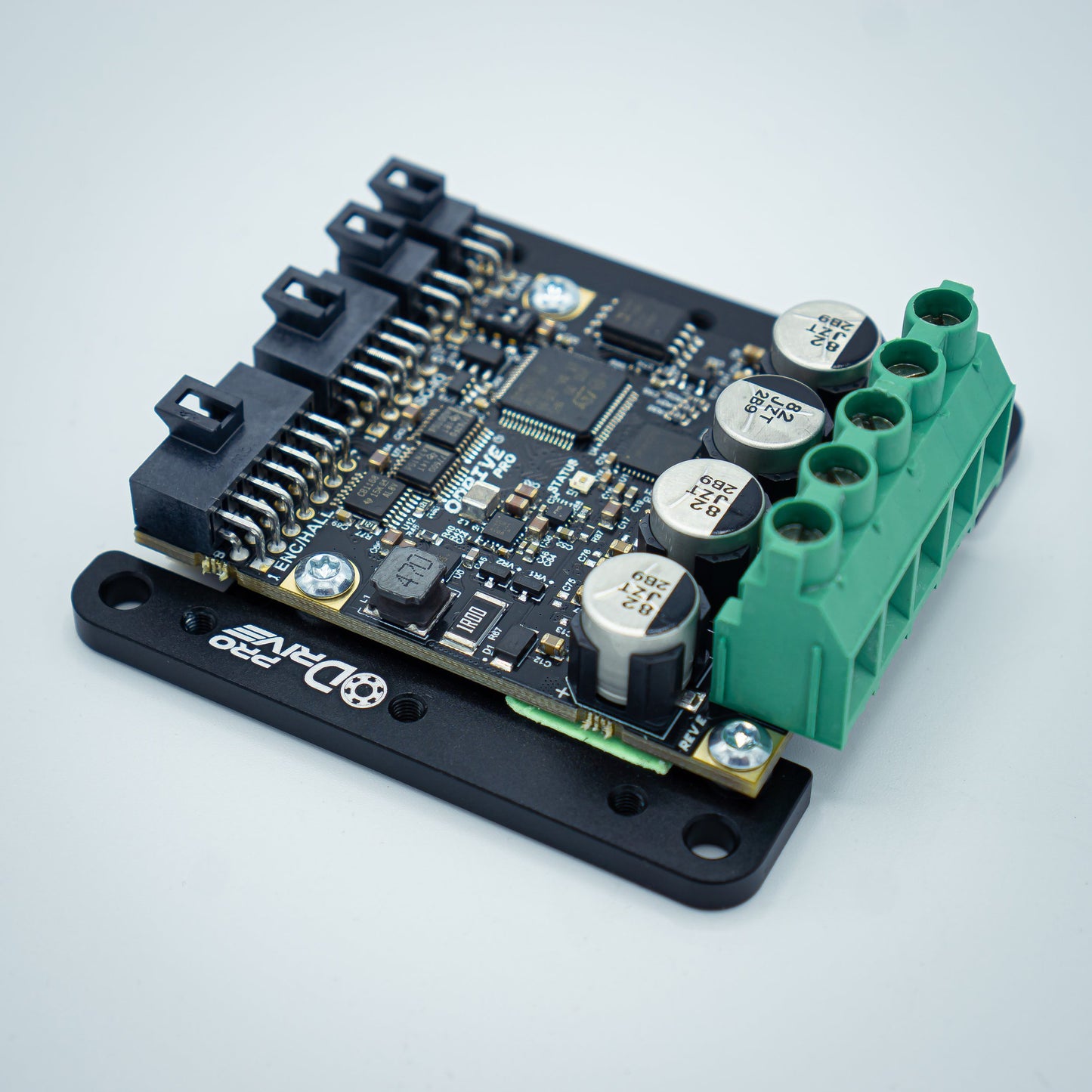

Shown with enclosure or heat spreader plate: recommended, sold separately.

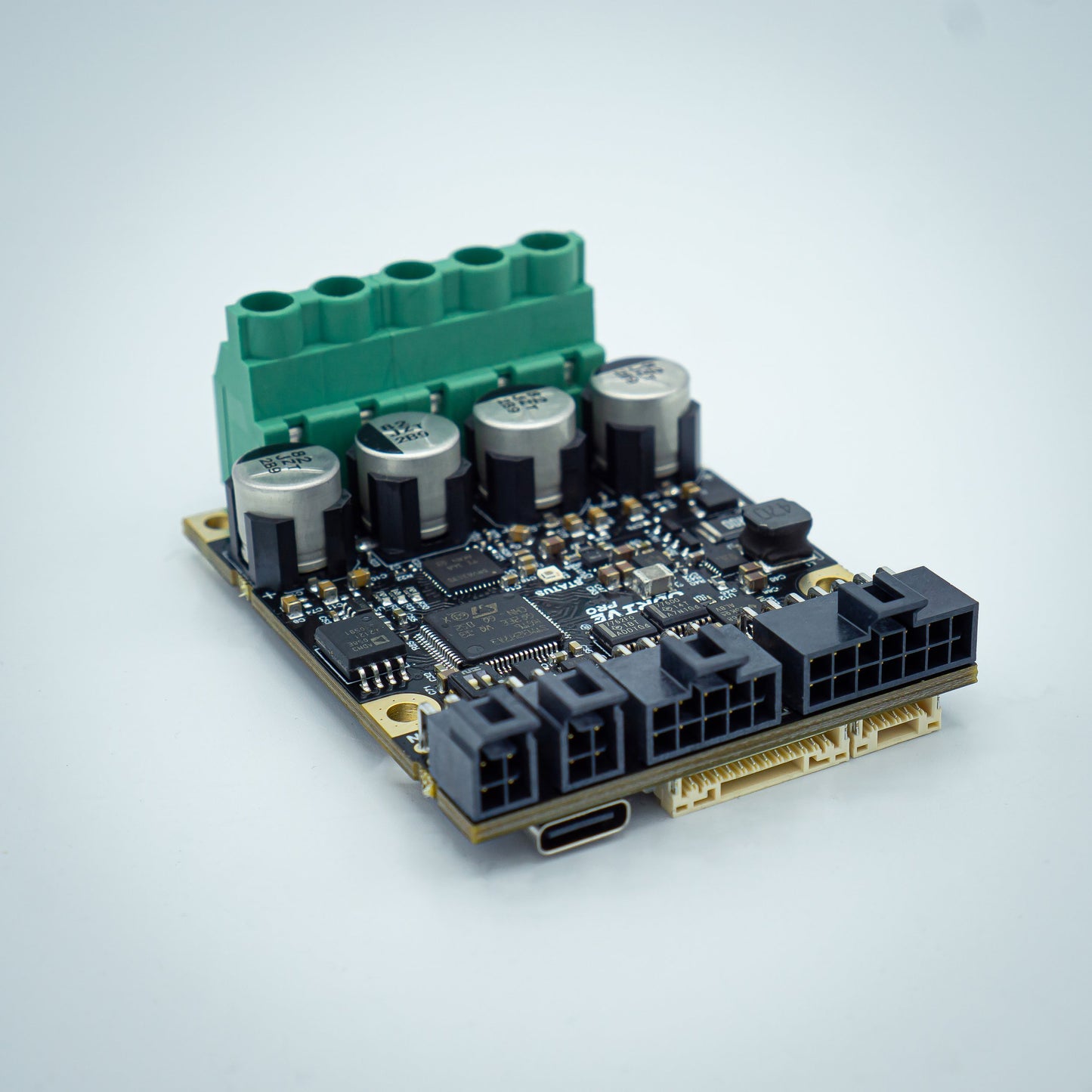

Locking IO connectors usable with the Harness Build Kit and CAN cables.

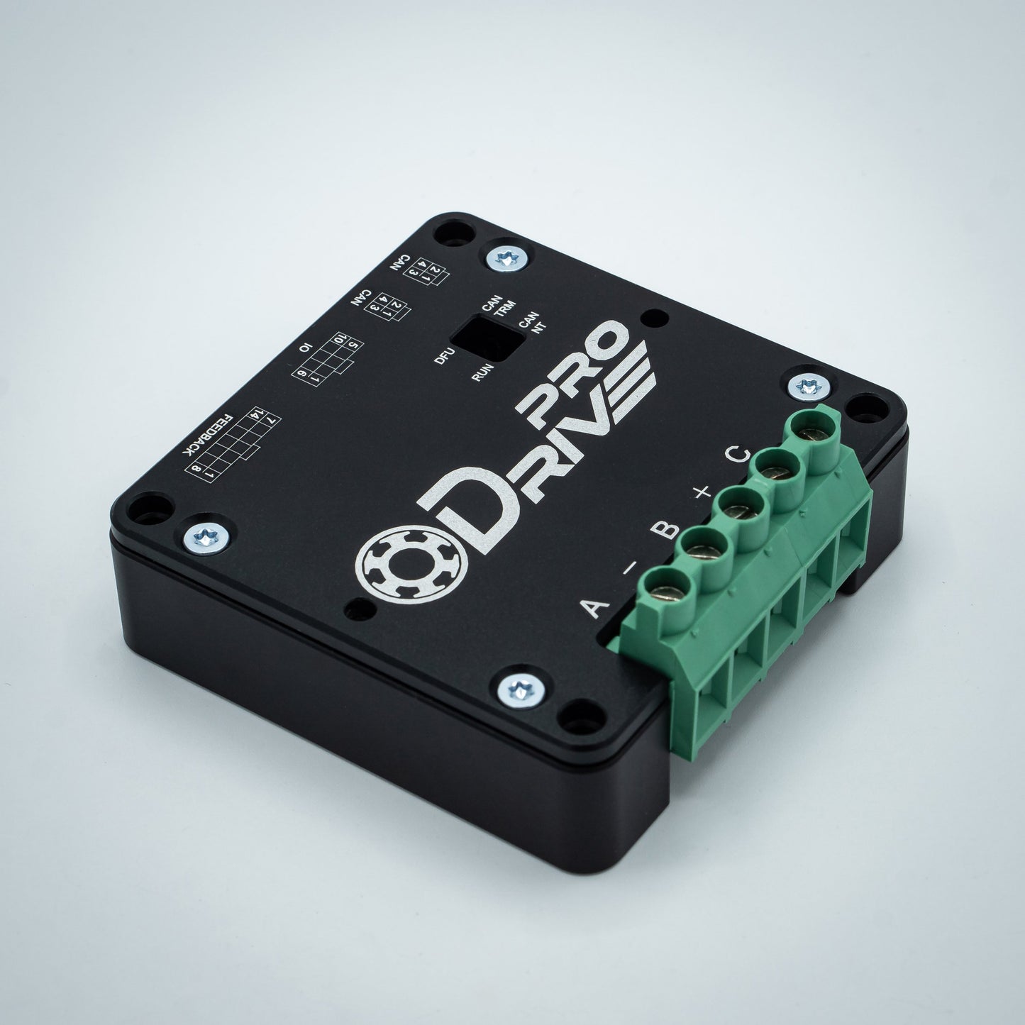

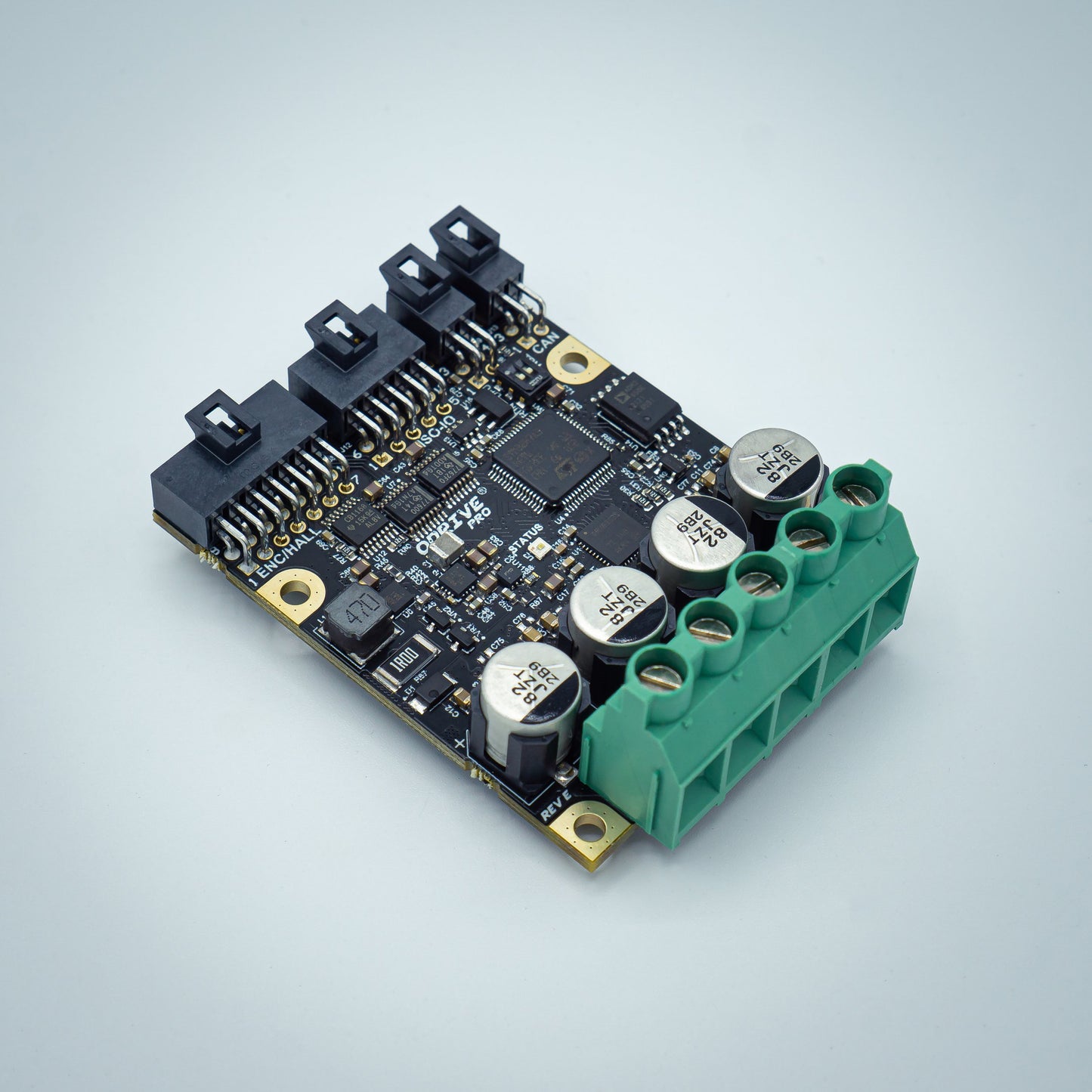

The ODrive Pro meets the needs of your demanding robotics application, with:
  • Locking connectors for high reliability wire harness
  • Ultimate reliability and high performance in 5 x 6.5cm
  • Dual absolute encoder support for precise load positioning and instant cold starts
  • Up to 5kW peak, 3kW continuous power with appropriate cooling
  • Shared software architecture with all current generation ODrives, including Web GUI support
Features & Specs
  • Single-axis (controls 1 motor)
  • High performance servo control of BLDC, PMAC, and ACIM motors
  • Torque, velocity, position, and trajectory control modes
  • Sensorless speed control
  • 12-56V Operation (58V max)
  • Up to 70A continuous, 100A peak current with heatsink and fan

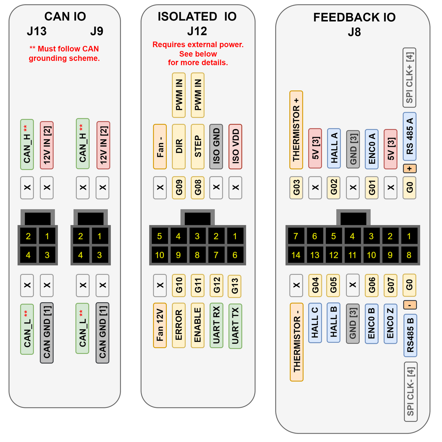

  • Control over USB, UART (Isolated), STEP/DIR (Isolated), Analog Voltage, PWM (Isolated), and CAN (Isolated)
Electrical Features
  • CAN 2.0B @ 1Mbps Control (10Mbit/s CAN-FD, experimental)
  • On-board magnetic encoder: MA702
  • Supports offboard quadrature, hall, SPI, SSI, and RS485 encoders. Experimental BiSS-C support
  • Incremental encoders and hall sensors have on-board input filters
  • Isolated CAN, UART, Step/Dir and PWM control inputs
  • Locking IO connectors with a diverse and flexible feature set.

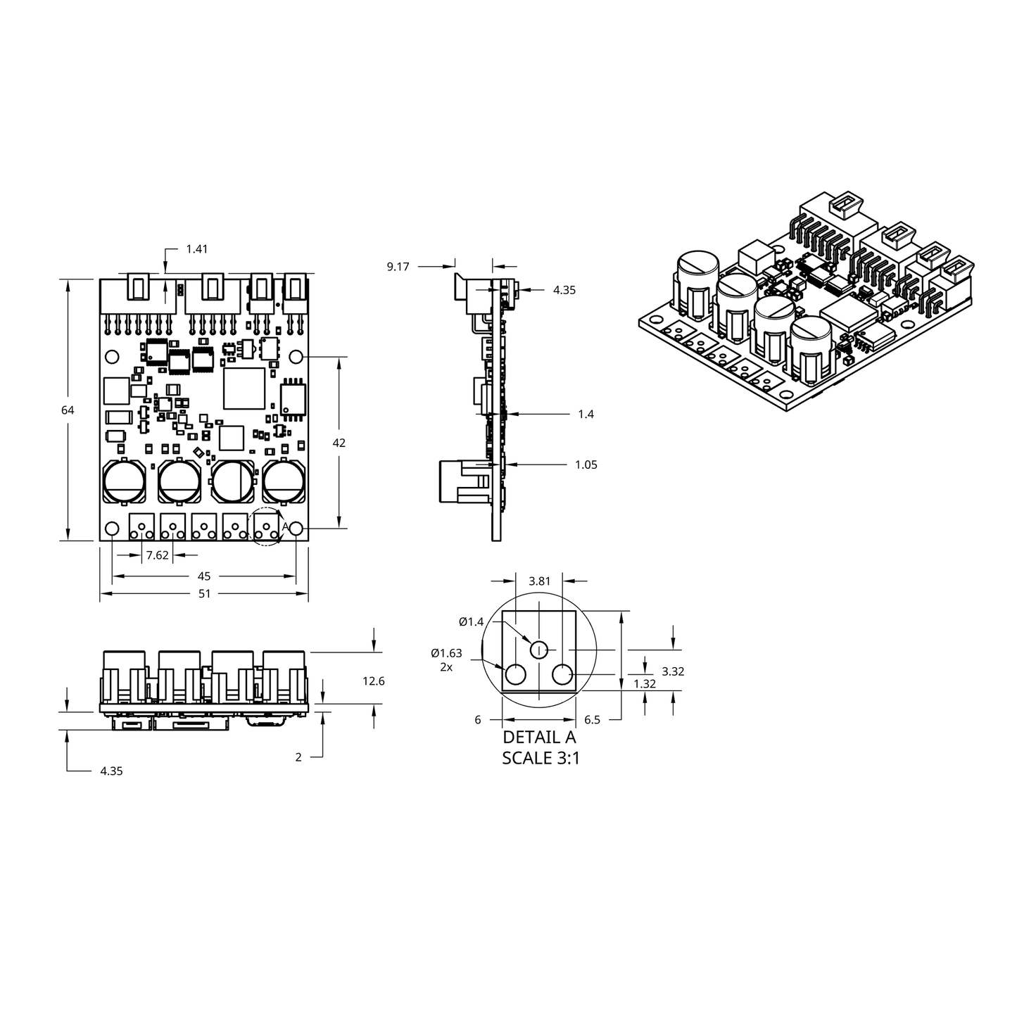

  • Mass - 35g (no screw terminal) | 55g (screw terminals present)
  • Board Perimeter - 51mm x 64mm
  • Locking Molex Nano-Fit connectors for IO & Feedback
  • Locking, low profile JST-GH connector for extra IO
