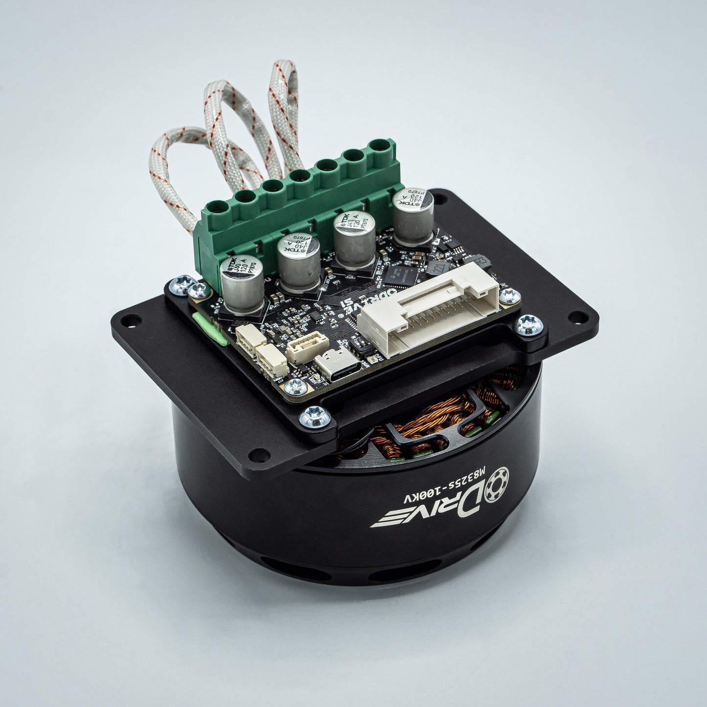

Mount the ODrive on the back of a motor.
Heat spreader plate or enclosure required, you cannot mount the ODrive Pro directly.

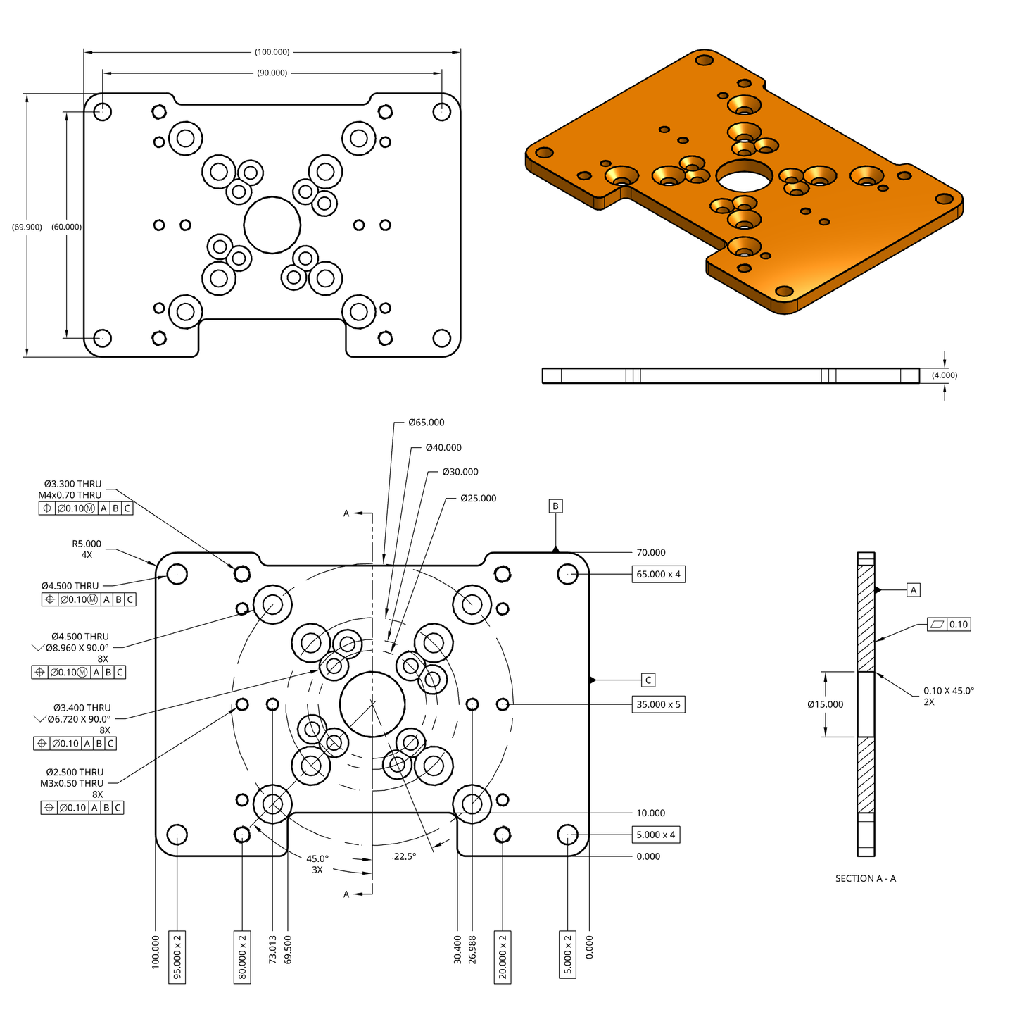

Fits motors with square screw patterns (see drawing):
M3 x4 on 25mm diameter circle
M3 x4 on 30mm diameter circle (fits D5312s)
M4 x4 on 40mm diameter circle (fits M8325s)
M4 x4 on 65mm diameter circle
