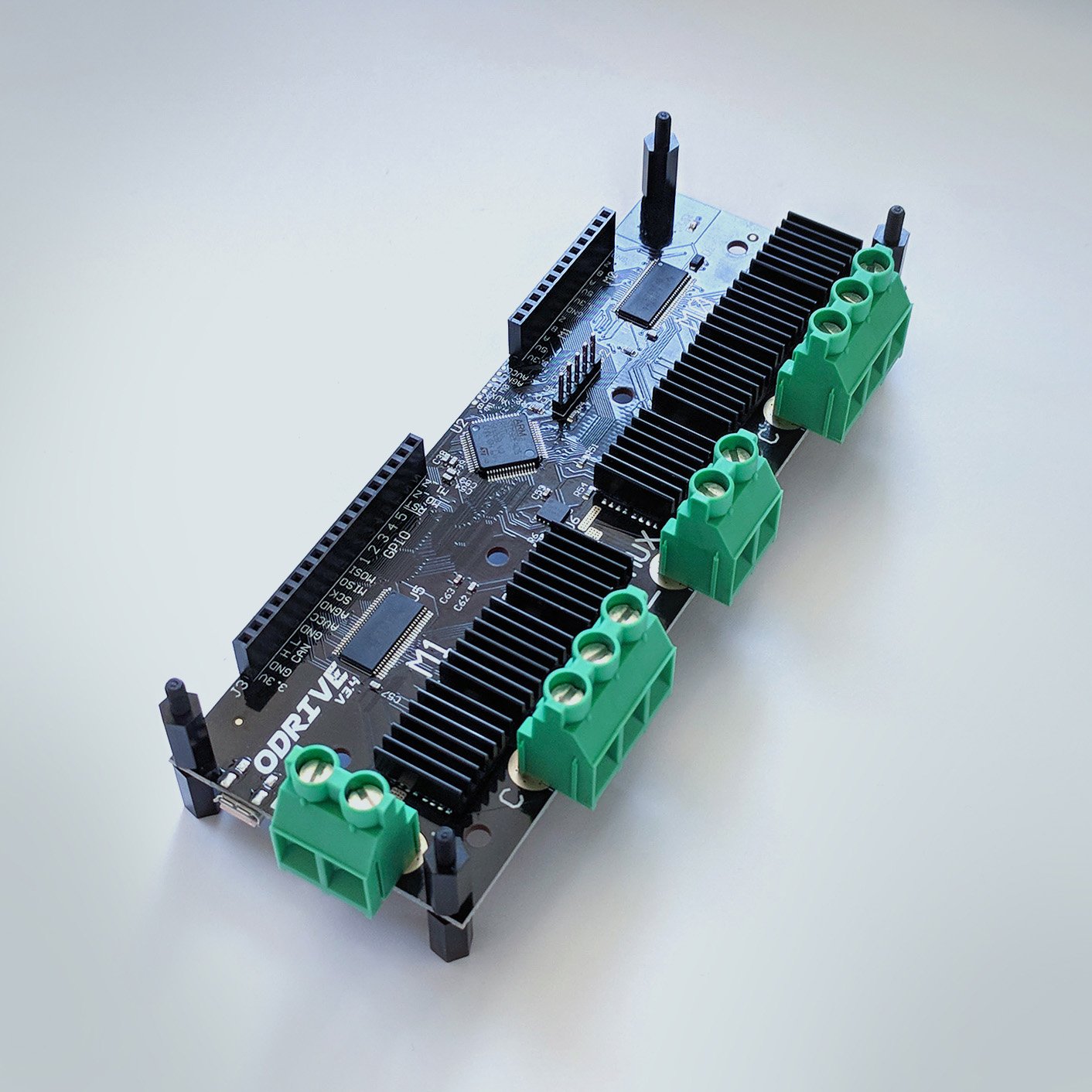

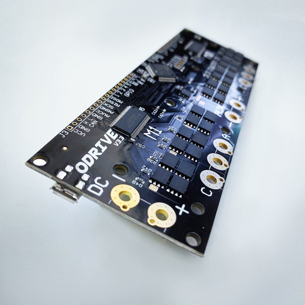

A board without connectors looks like the last picture, which makes it easier to fit into small enclosures and apply custom cooling, but you must solder your own connectors or directly to the board.

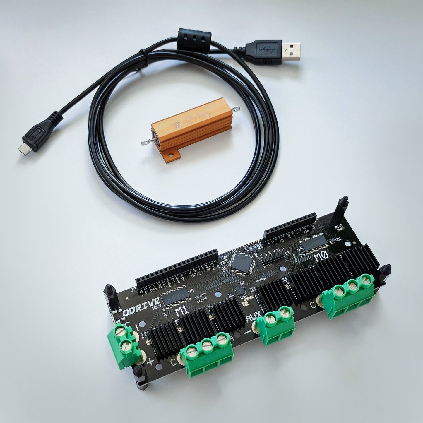

This listing Includes the ODrive v3.6 board, a power resistor (for brake energy dissipation), heatsinks, and some nylon standoffs. The pictures show older versions, but you will receive a v3.6.
