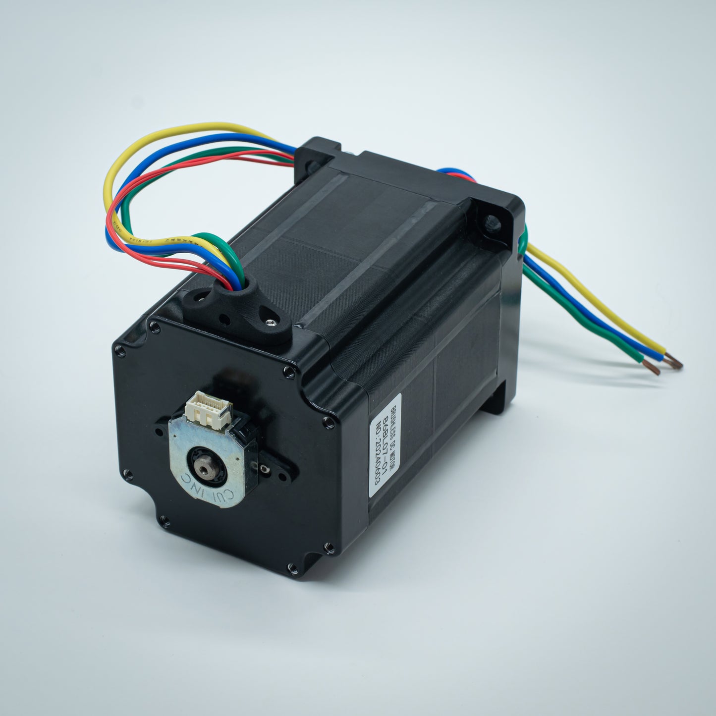

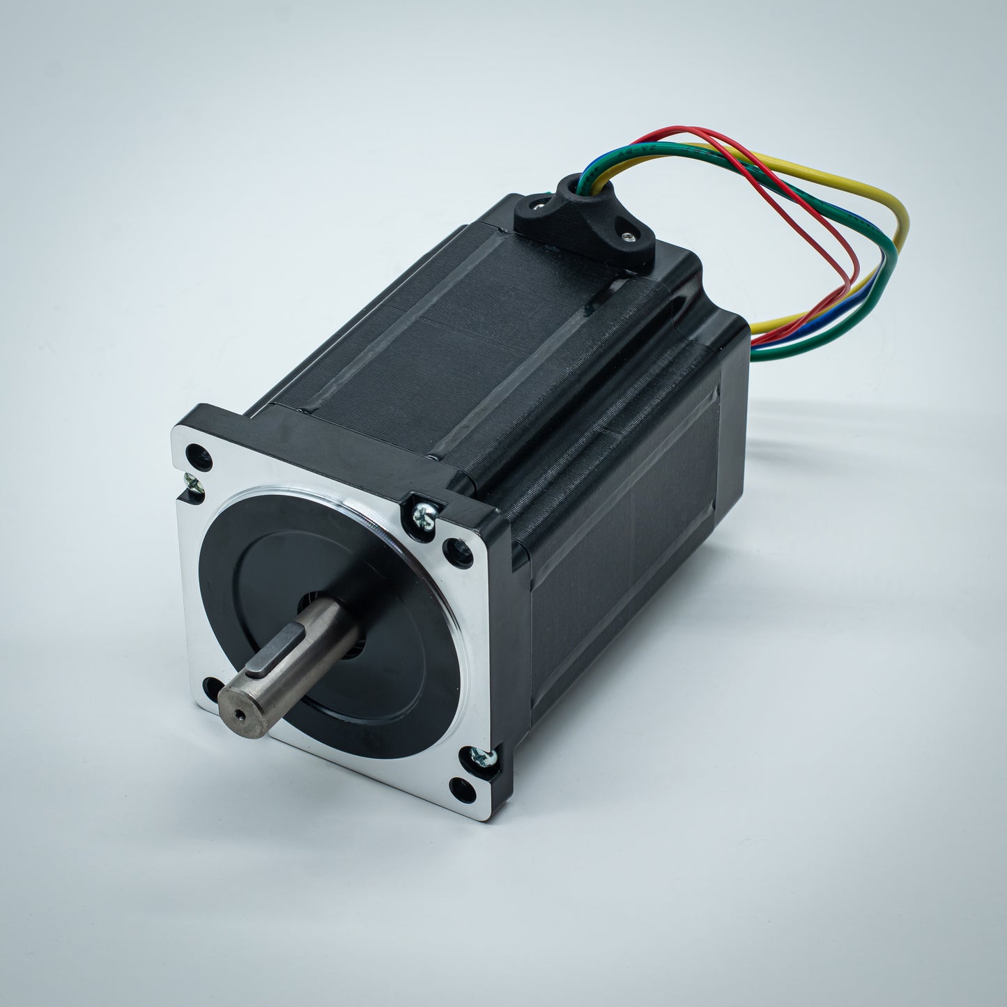

This brushless servomotor comes in a NEMA 34 frame size, with a high-performance absolute encoder preassembled! Perfect for compatibility with NEMA 34 gearboxes and mounting patterns. This quiet and precise motor features a low-cogging rotor, allowing for smooth, precise motion even at low speeds — even better with anticogging!
Encoder Cables can be purchased separately:

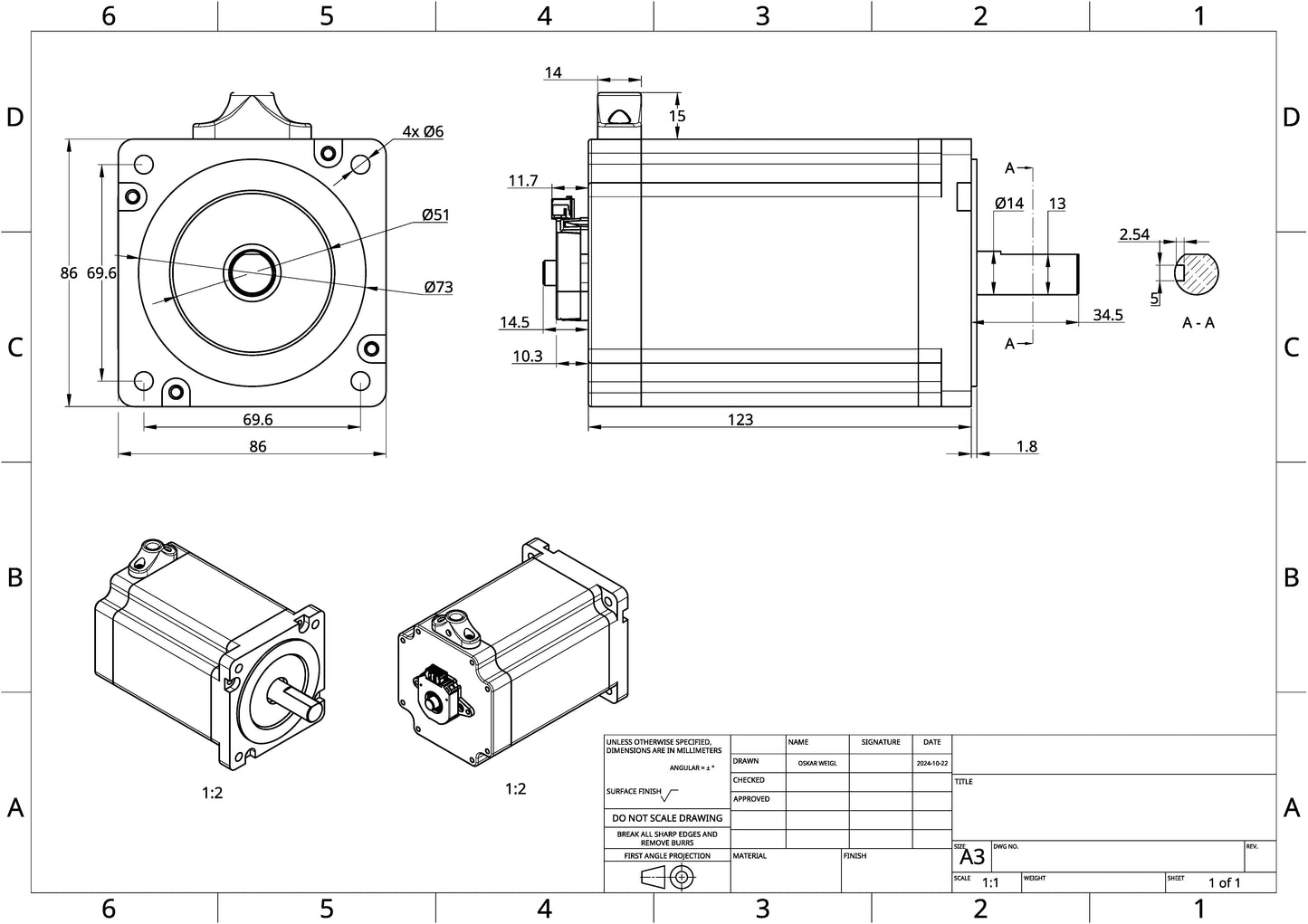

  • Shaft Diameter: 14mm w/ flat and 5x20mm keyway (key included)
  • Shaft Length: 35mm
  • Motor length: 125mm (inc. front boss, not inc. shaft or encoder)
