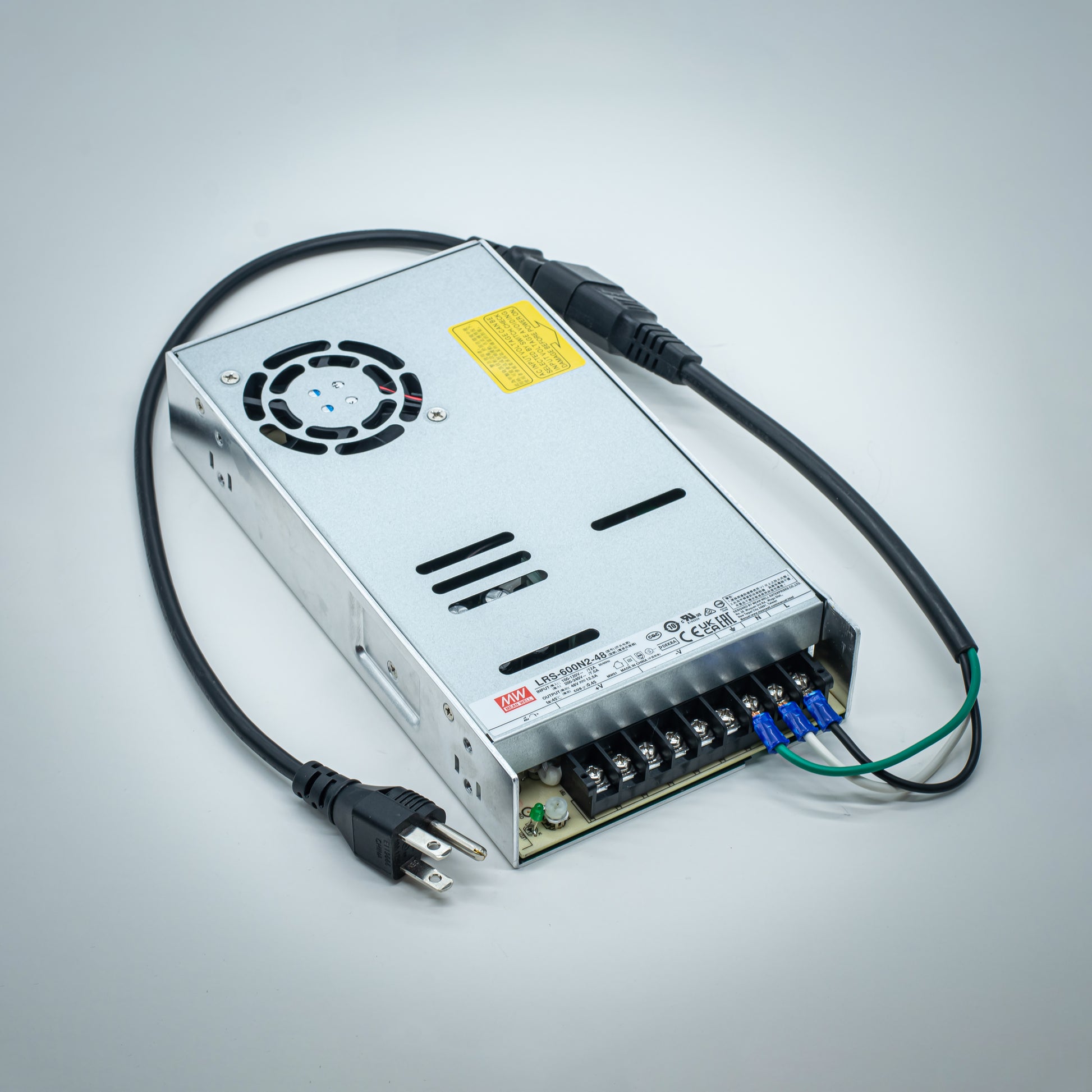

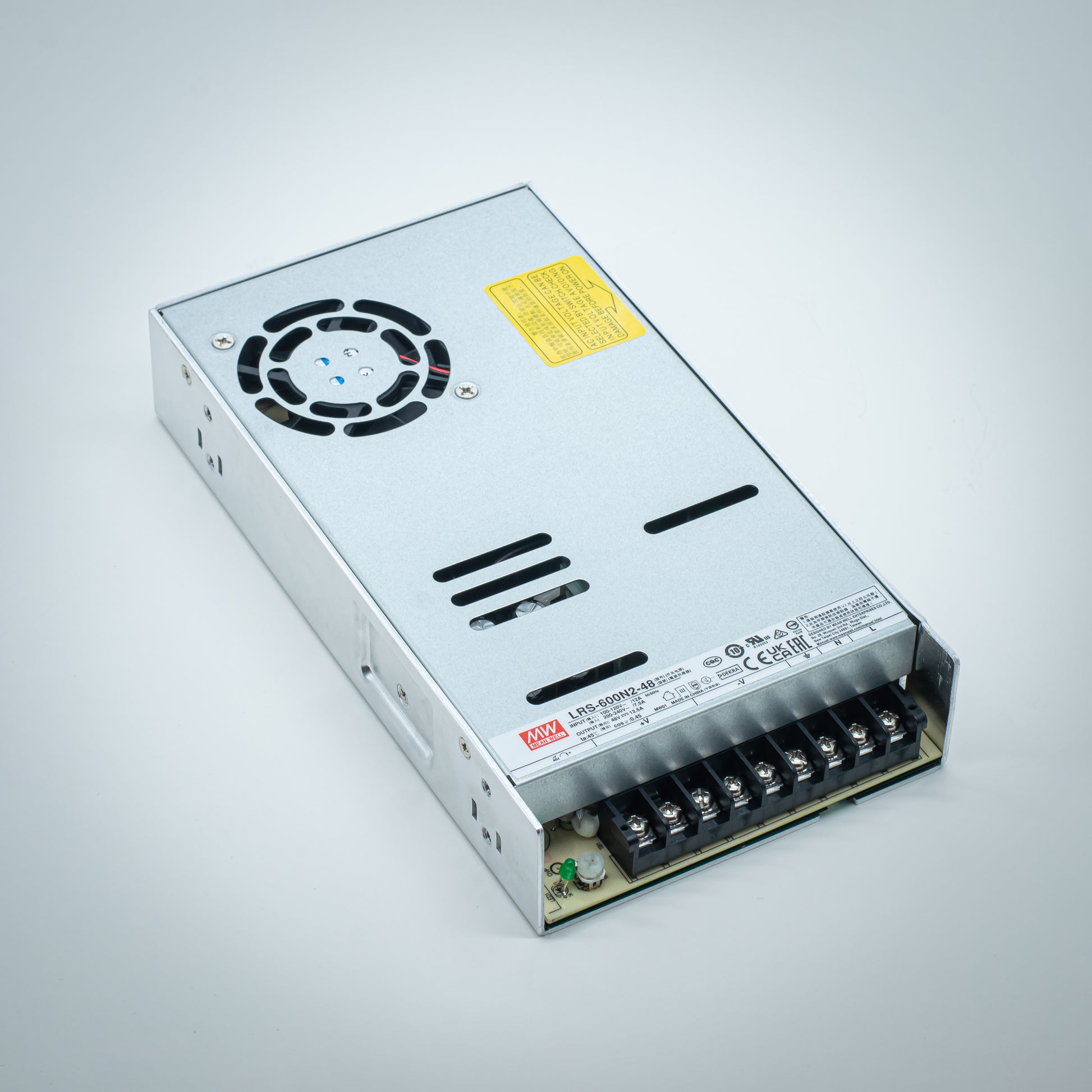

This is a 48V 600W (12.5A) Mean-Well power supply with a special feature — it can output up to 200% of its rated power for up to five seconds! This is a brand-new offering from Mean-Well, and perfect for systems that need peak power for acceleration.
It's a perfect match with the Regen Clamp, and optionally comes with an IEC connector with spade terminals for easy wiring.

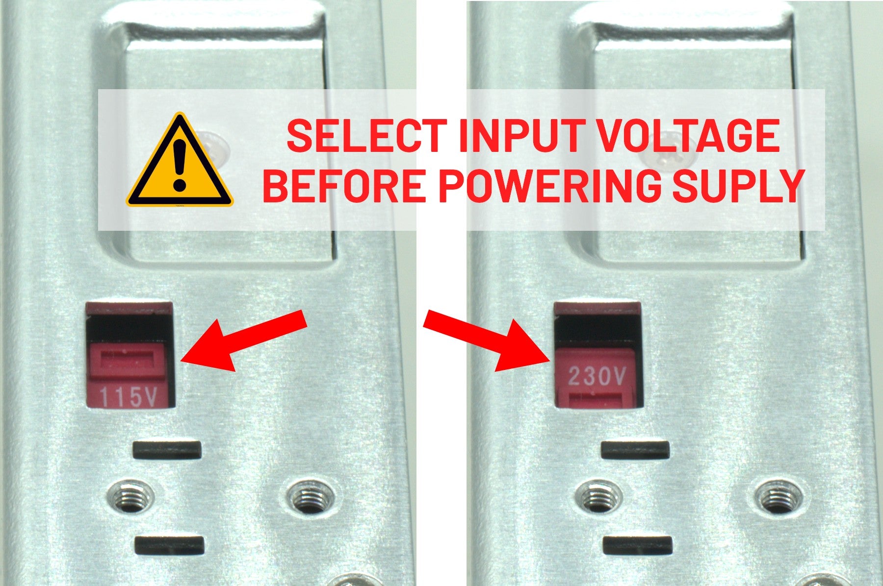

Remember to select your input voltage (110V or 220V) with the switch on the side before powering up!

- No cable: LRS-600N2-48
- IEC to Spade Terminals: LRS-600N2-48-IEC
- IEC to Spade Terminals + IEC to US Outlet: LRS-600N2-48-IEC-WALL
Specifications:
- Part Number: LRS-600N2-48
- Input Voltage: 115V/230V (50-60Hz)
- Output Voltage: 48V
- Continuous Output Current: 12.5A
- Continuous Output Power: 600W
- Maximum Peak Power (220V input): 200% (1200W, 25A)
- Maximum Peak Power (110V input): 160% (960W, 20A)
Mean-Well LRS-600N2-48 Datasheet

IEC to Spade Terminal Cable: 1' (300mm) IEC 320-C14 inlet with quick-connect spade terminals. 16AWG / 10A rated.
IEC to US Outlet: 1.5' (460mm) IEC 320-C13 connector to NEMA 5-15P plug. 18AWG / 10A rated.
Power Supply Wiring:
⏚ (Ground) to Green
N (Neutral) to White
L (Live) to Black
