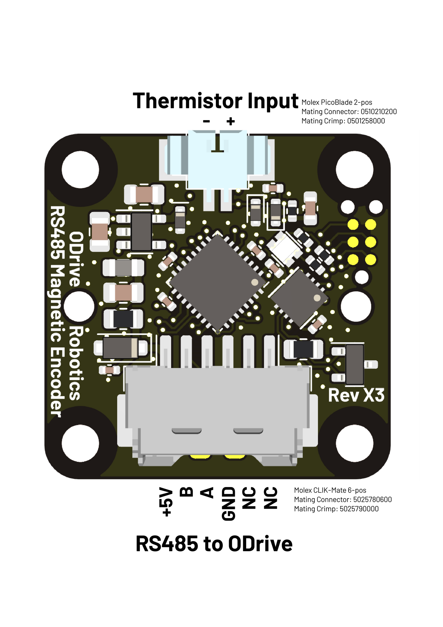

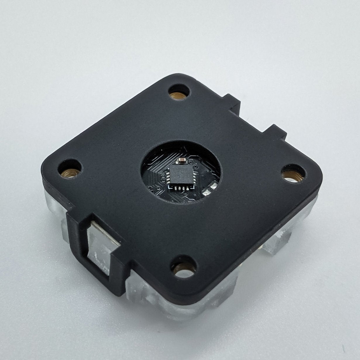

  • 12-bit MA702 magnetic encoder (same as ODrive Pro and S1)
  • Recommended for use with ODrive encoder magnet (not included). Recommended distance 1mm from bottom of case.
  • Maximum Speed: 60,000 RPM
  • RS485 interface for robustness and reliability, even with long cables in high-EMI environments
  • Seamless integration with ODrive Pro and S1 (connect with the wire harness for Pro or S1)

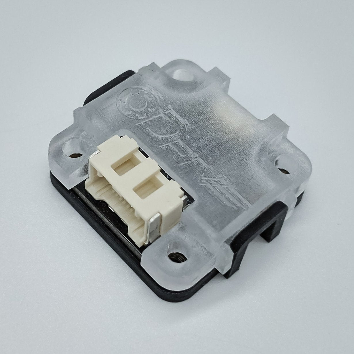

  • Included case for protection and ease of mounting
  • 10k thermistor input, allowing both motor position and temperature sensing over a single cable (requires ODrive firmware update, coming soon)

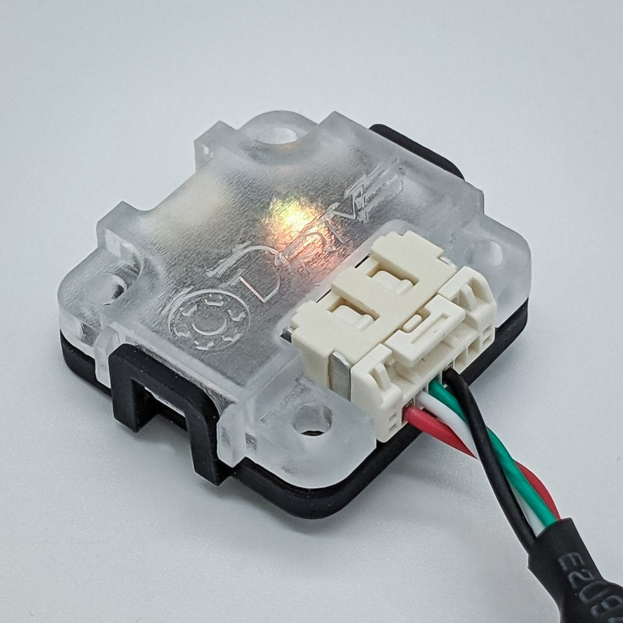

  • Onboard indicator LED to help encoder positioning for optimal magnetic field strength

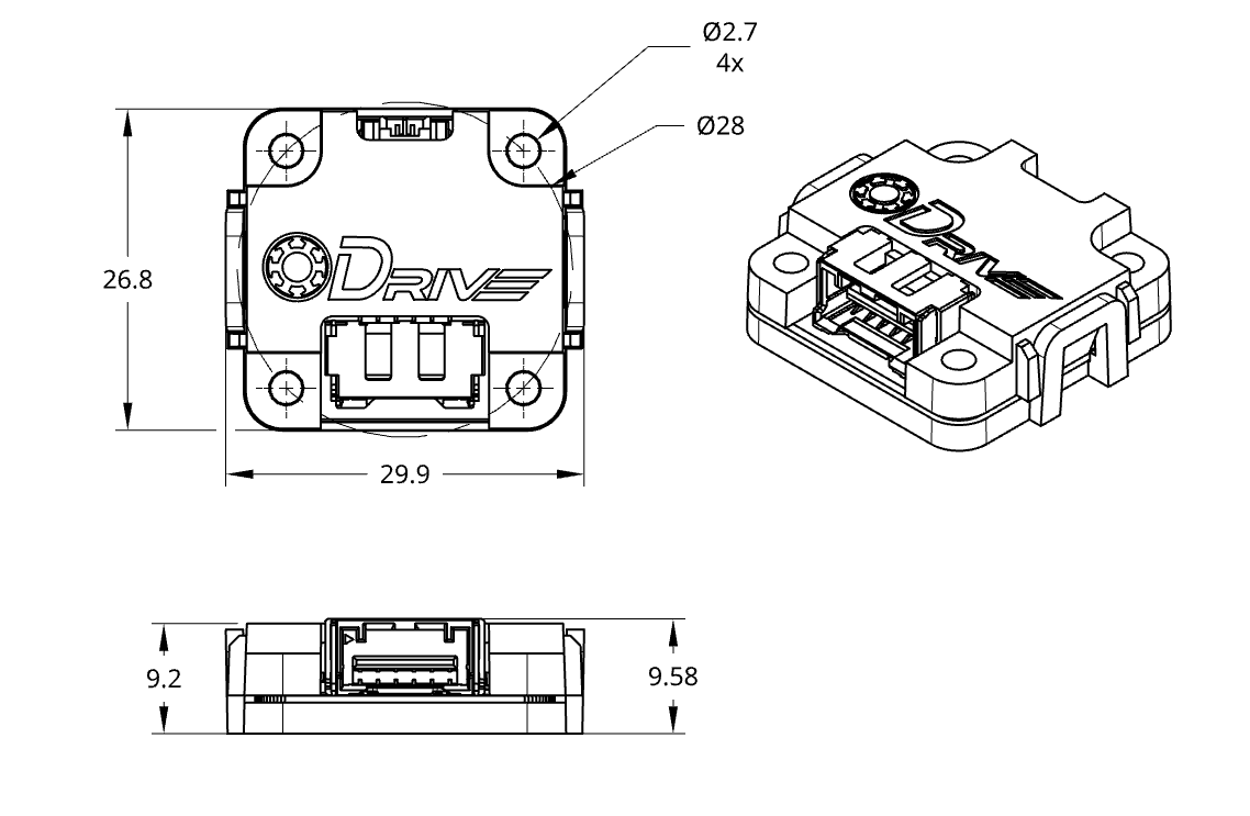

Mounting details:
  • 4x M2.5 (clearance) on a 28mm bolt circle

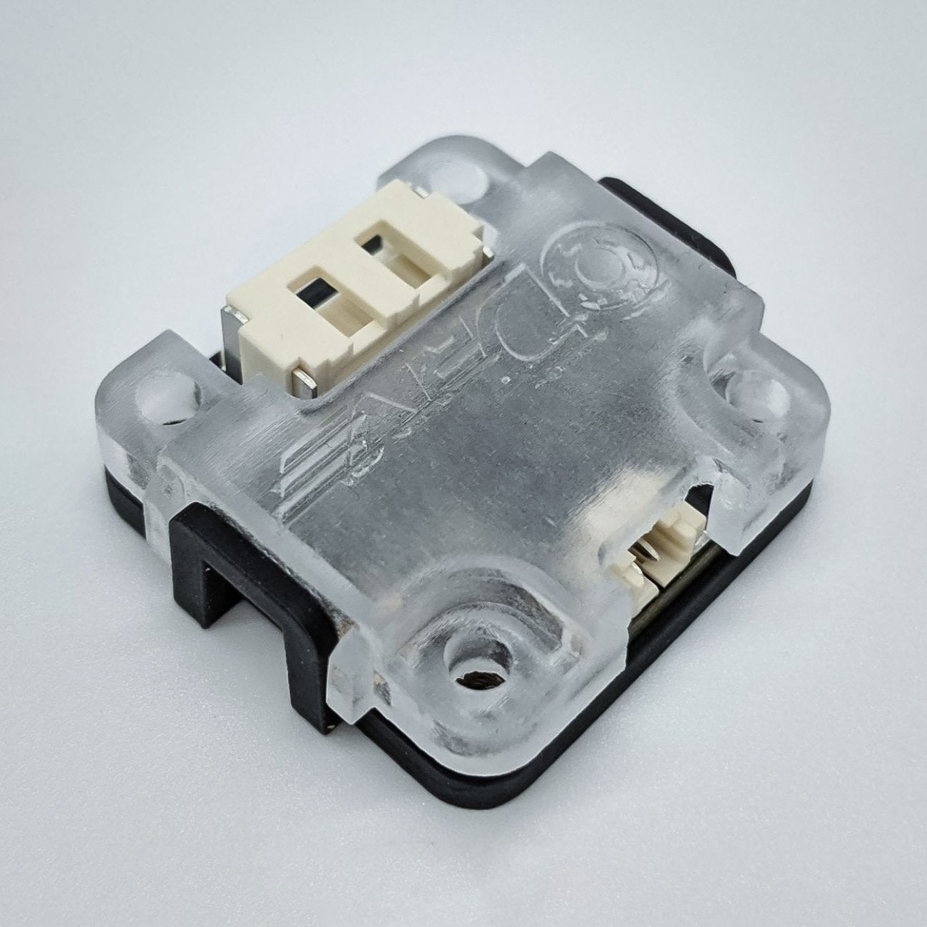

  • Thermistor connector is 2-pos Molex PicoBlade
  • ODrive RS485 connector is 6-pos Molex CLIK-Mate
