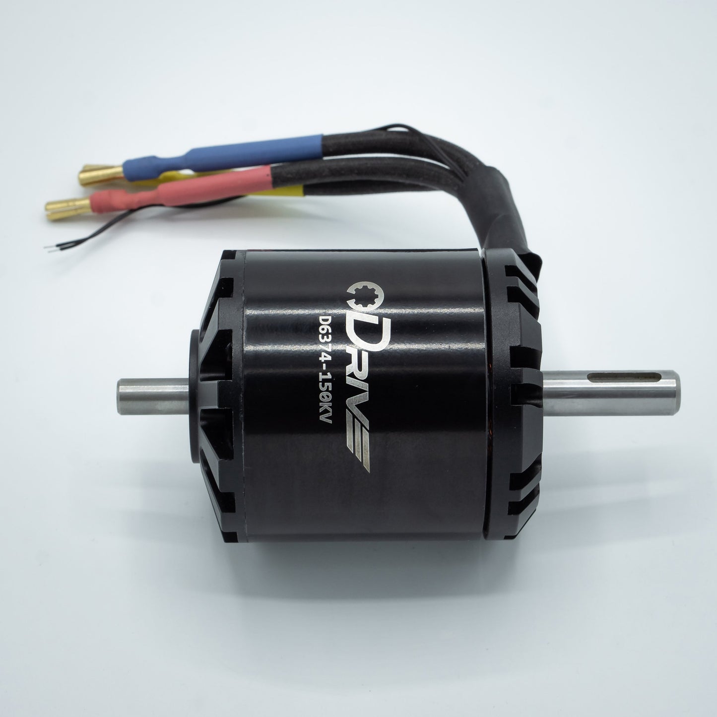

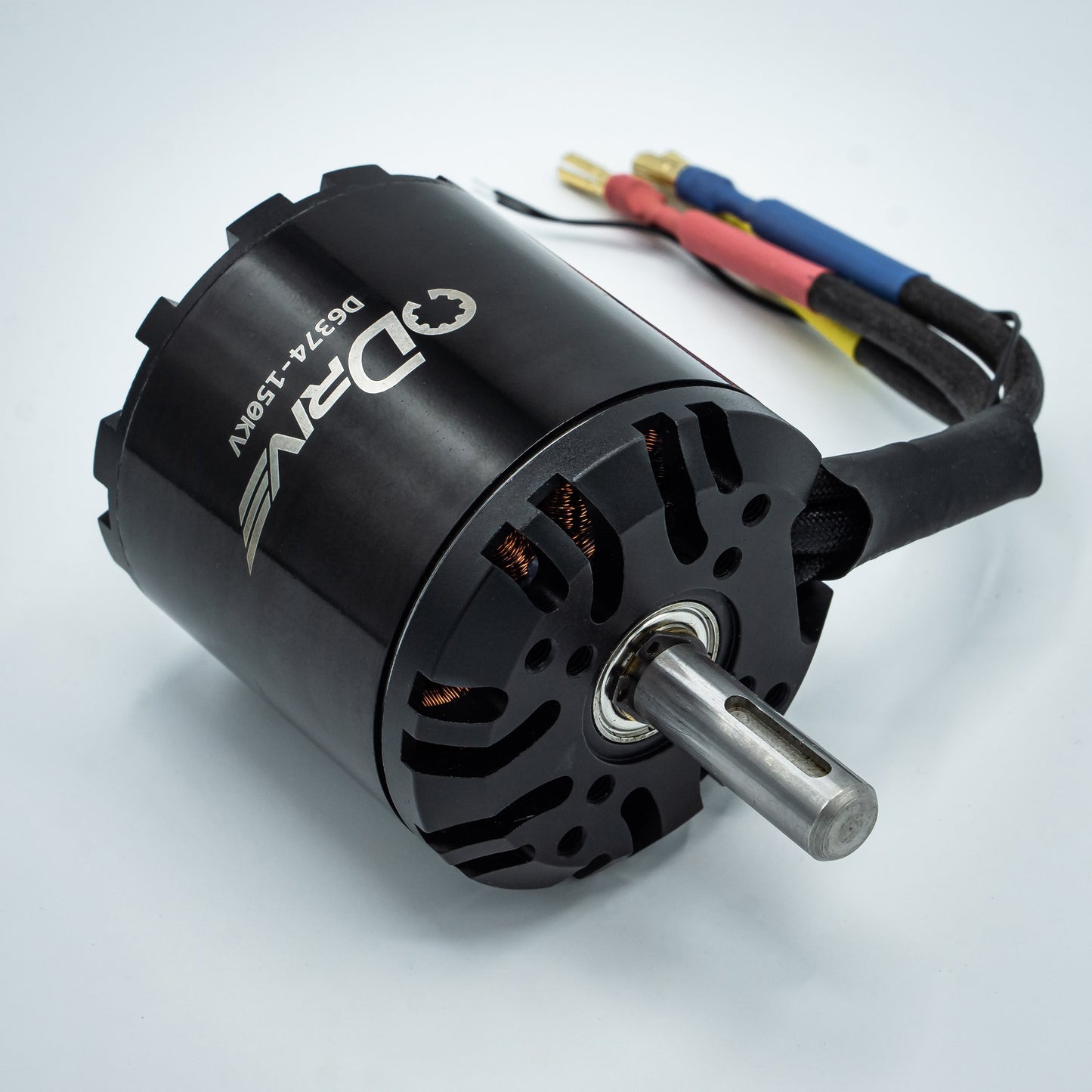

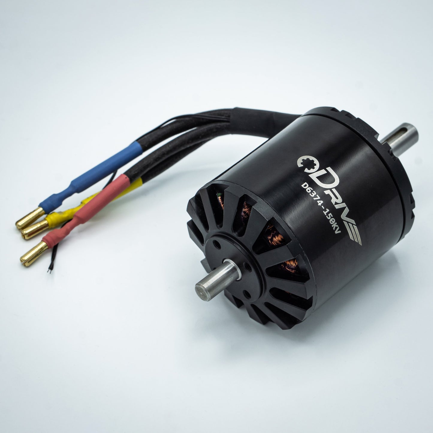

  • 10mm primary shaft with flat and keyseat, see drawing.
  • 8mm secondary shaft, for possible use with CUI AMT-212 encoder (for ODrive Pro and S1), or CUI AMT-102 encoder (for ODrive v3.6).
  • Performance specifications found in ODrive Motor Guide.
  • This motor has 7 pole pairs and 12 stator slots (12n14p).
  • Includes a thermistor thermally connected to motor windings to monitor temperature (NTC 10k 1% 3435).
  • Black color with laser-etched ODrive logo and model number (D6374 - 150KV).
  • Motor phases have 4mm male bullet connectors.
