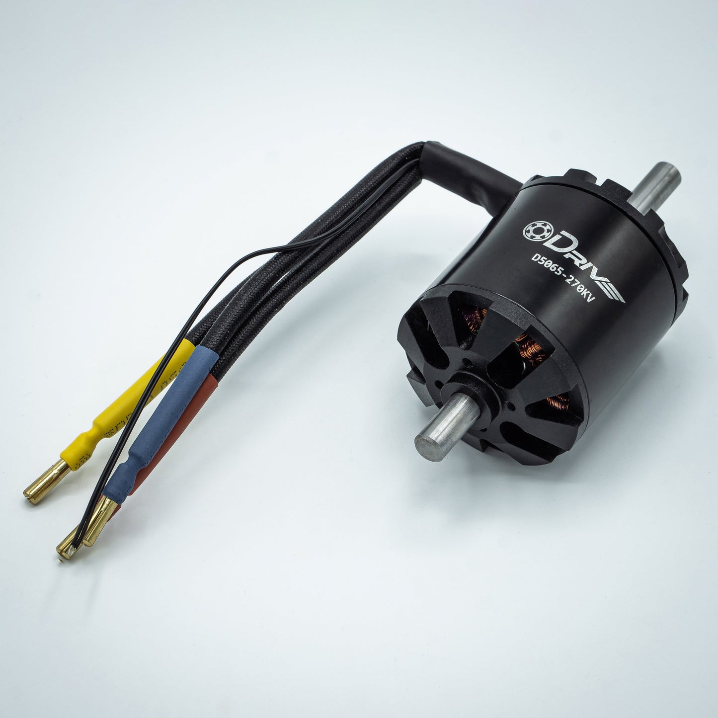

See motor characteristics here.

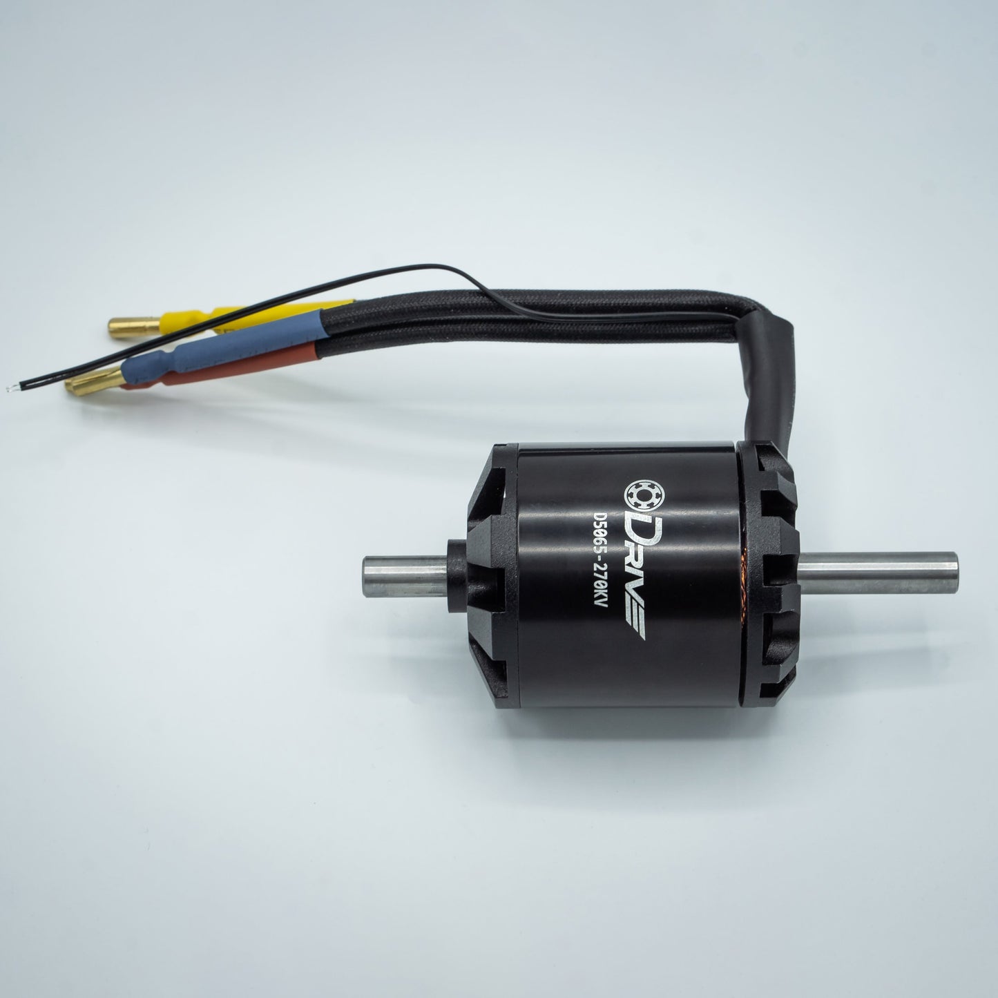

- 8mm primary shaft with flat, see drawing.
- 8mm secondary shaft, for possible use with CUI AMT-212 encoder (for ODrive Pro and S1), or CUI AMT-102 encoder (for ODrive v3.6).
- Performance specifications found in ODrive Motor Guide.
- This motor has 7 pole pairs and 12 stator slots (12n14p).
- Includes a thermistor thermally connected to motor windings to monitor temperature (NTC 10k 1% 3435).
- Black color with laser-etched ODrive logo and model number (D5065 - 270KV).
- Motor phases have 4mm male bullet connectors.

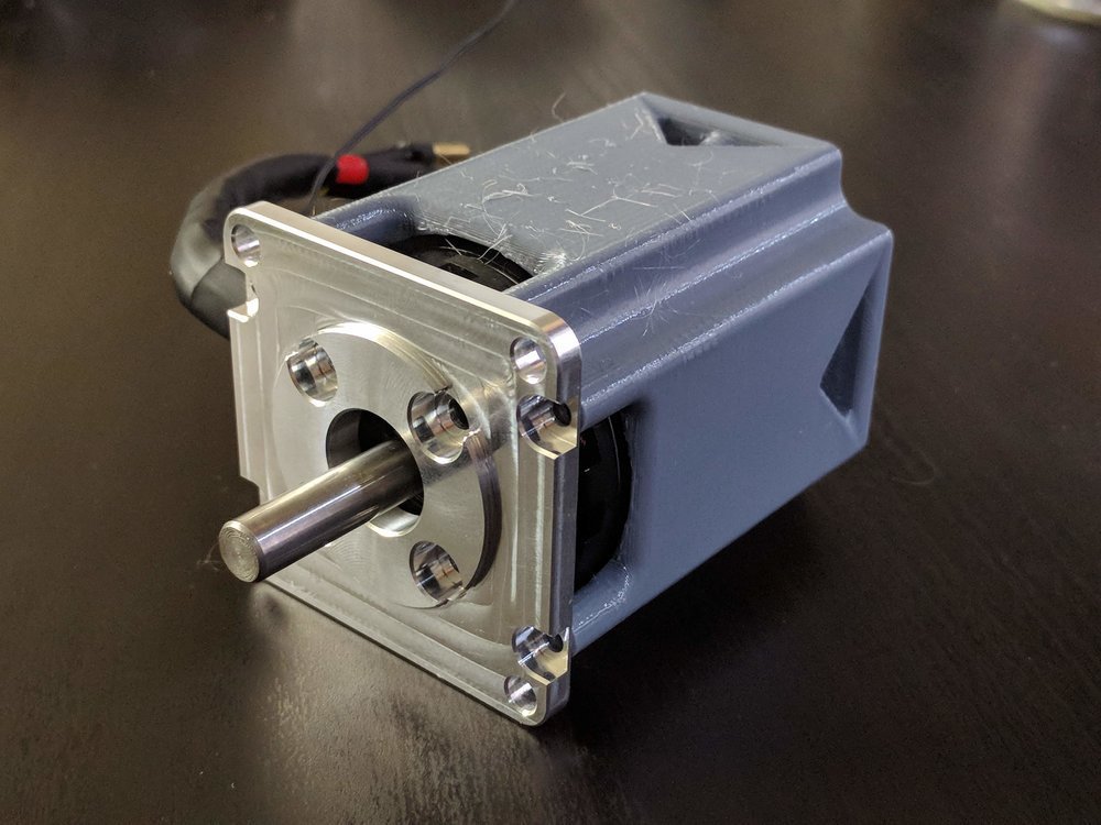

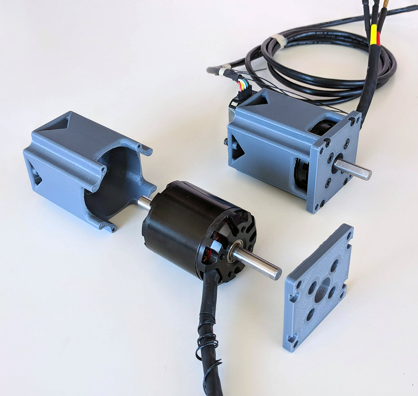

- 3D printable enclosure: Files and details.
