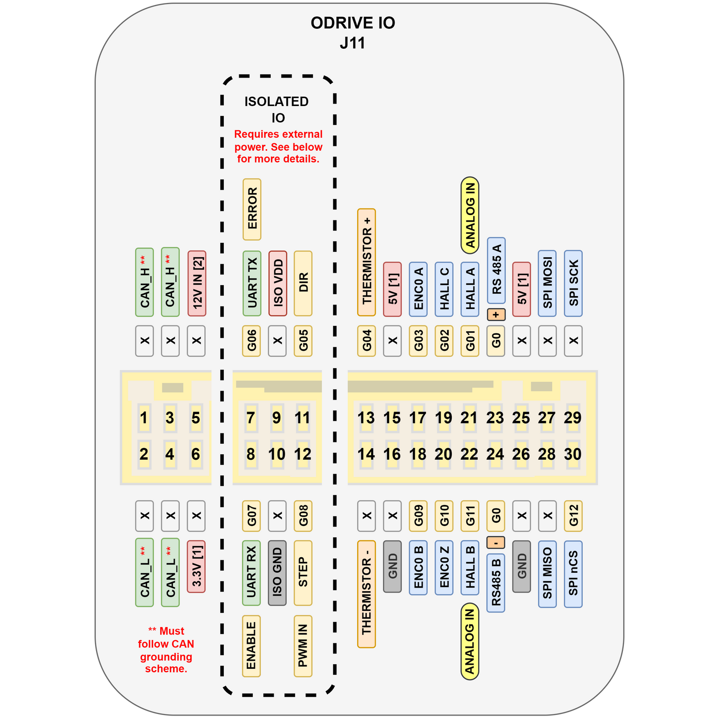

  • Control over USB, UART (Isolated), STEP/DIR (Isolated), Analog Voltage, PWM, and CAN

  • On-board magnetic encoder: MA702
  • Supports offboard quadrature, hall, SPI, and RS485 encoders
  • Incremental encoders and hall sensors have on-board input filters
  • Isolated Step/Direction and UART Controls
  • Large IO connector with a diverse and flexible feature set.

  • Single locking connector for IO & Feedback
