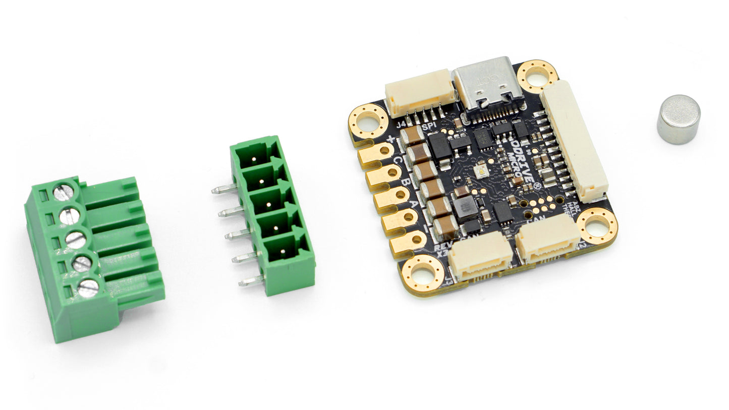

Included: an encoder magnet, and optional screw terminals you can solder on.
Recommended: wire harness kit, CAN daisy chain cables.

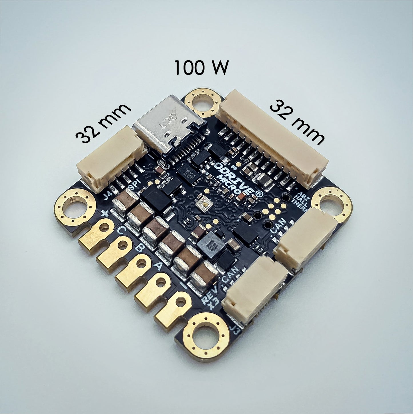

The ODrive Micro fits in every nook and cranny, bringing up to 100W of high-precision motor control to your application, with:
  • Locking connectors for high reliability wire harness
  • A tiny 32 mm x 32 mm x 7.5 mm form factor
  • Up to 180W peak, 100W continuous power
  • Onboard magnetic encoder for back-of-motor mounting
  • Shared software architecture with all current generation ODrives, including Web GUI support
  • Customization, integration and licensing available

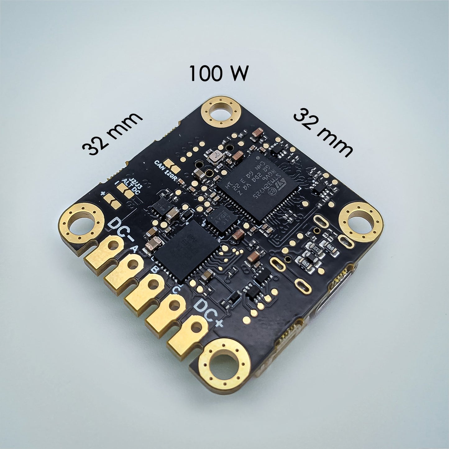

  • Single-axis (controls 1 motor)
  • High performance servo control of BLDC, PMAC, and ACIM motors
  • Torque, velocity, position, and trajectory control modes
  • Sensorless speed control
  • 10-30V Operation (32V max)
  • Up to 3.5A continuous, 7A peak current

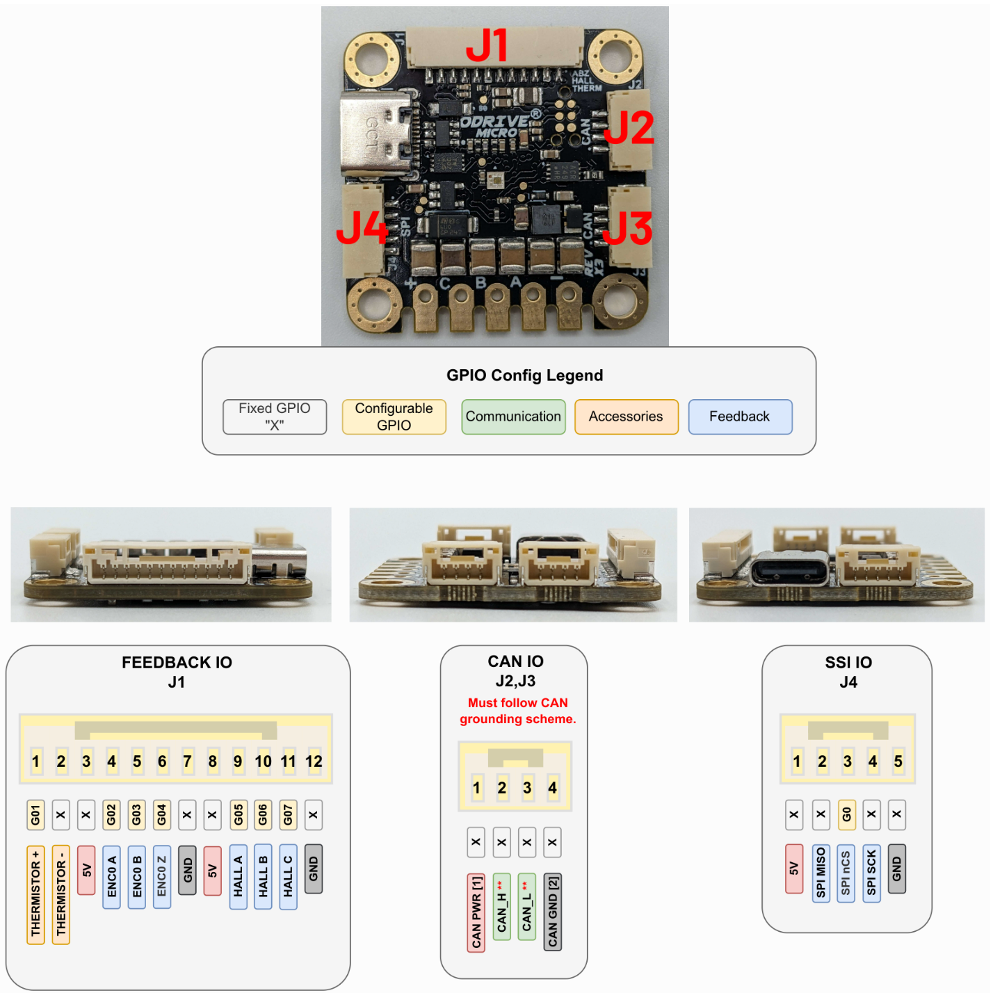

  • CAN 2.0B @ 1Mbps with simple protocol (CAN-FD Firmware Coming Soon)
  • On-board magnetic encoder: MA702
  • Supports offboard quadrature, hall, and SPI encoders.
  • Incremental encoders and hall sensors have on-board input filters
  • Daisy-chainable CAN connectors for easy wiring

  • Locking, low profile JST-GH connectors for I/O and feedback
