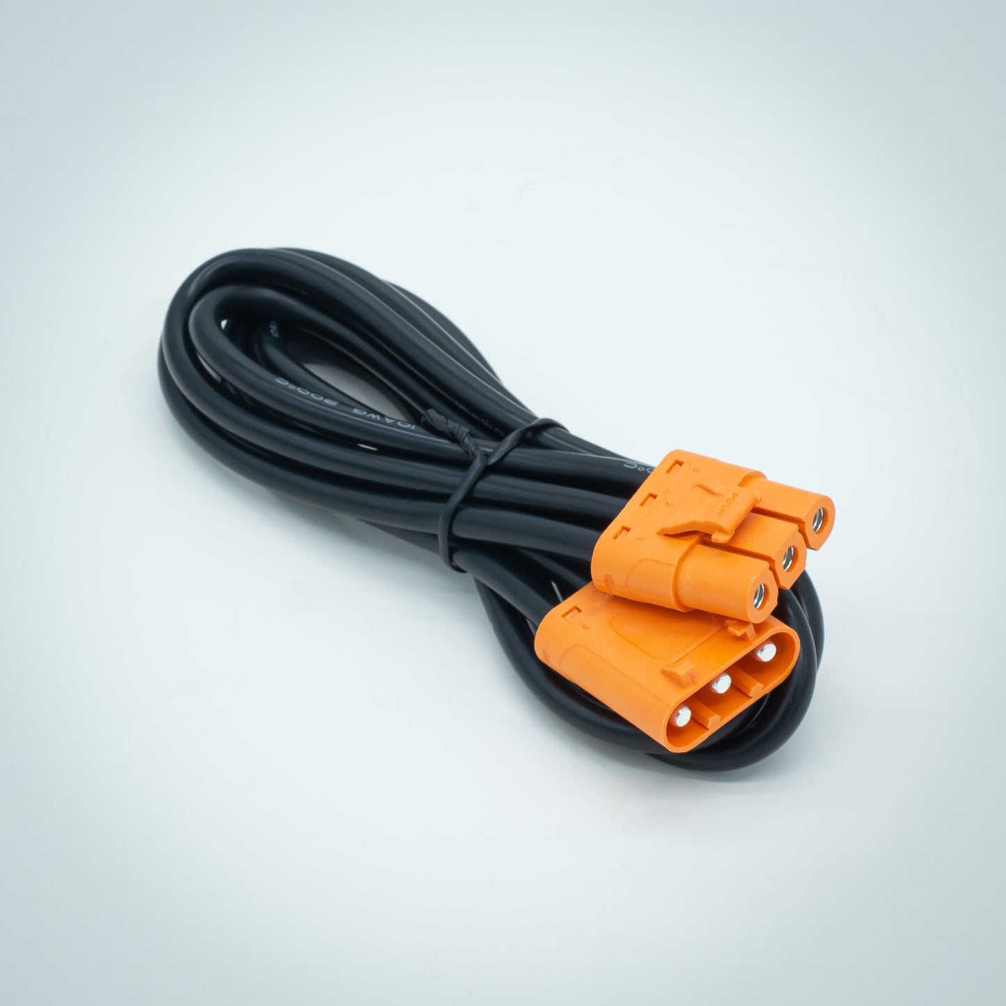

A three-phase motor power cable, using the new AMASS LC connector series! These locking motor power cables are perfect for making easy-to-assemble and reliable connections between a motor and an ODrive.
Using motor current amplitude:
Choose the LCC30 cable for up to 70A at 35°C ambient.
Choose the LCC40 cable for up to 107A at 35°C ambient.
Cables are plug-socket, and can be chained for longer lengths.
Use with the ferrule adapter for connection to an ODrive screw terminal.
LCB30 cables use 12 AWG wire, LCB40 cables use 10 AWG wire.
